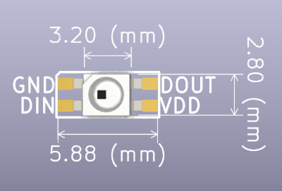

SK6812 RGB LEDs
| Pin | Description |
| VDD | 5 volt power supply |
| DIN | Data Input |
| DOUT | Data Output to next LED |
| GND | Ground |
SK6812 RGB LEDs are commonly found in long strips of color changing lights. 3 LED dies (red, blue, green) and an SK6812 controller chip are bonded to a bit of metal called a leadframe. The leadframe is put inside a casing and covered in epoxy. Then the whole thing is baked, like a cake.
The colors are set with a single wire, time-based protocol. Multiple LEDs can be chained together, with the DOUT of one LED connecting to the DIN of the next.
18 of these RGB LEDs are on the Bus Pirate PCB, all wired up and ready to go. We’re just going to control one of them because all 18 LEDs at full power would be too much current for some USB ports.
Each LED die in the SK6812 (red, blue, green) uses 20mA at full power. 60mA is required to light all three dies at maximum brightness.

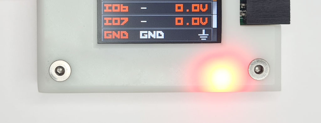

LED-()> [0b111111110000000000000000.24 RESET TX: 0b111111110000000000000000.24 LED-()>
Let’s start by lighting the red die in the LED. The Bus Pirate understands binary, hexadecimal and decimal formatted numbers. We’ll use binary entry first so it’s clear exactly how the bits control the LED.
- The data structure table above shows the format for controlling each color in the LED. The first eight bits control red, the next 8 control green and the final 8 control blue.
- Enter the WS2812 bus reset command
[. This command has two purposes. First, it tells the Bus Pirate to process this line as bus syntax. Second, it generates a 50us RESET delay so the LEDs are ready for new data. - Type
0bfor binary entry followed by eight 1s to set the red die to full brightness:0b11111111. - Add
00000000for green and00000000for blue to turn those dies off. - Finally, add
.24to tell the Bus Pirate we want to send 24 bits in one transfer. - The final command is kind of unwieldy:
0b111111110000000000000000.24 - Press
enterto send the command to the LED. The red die should light at full brightness.

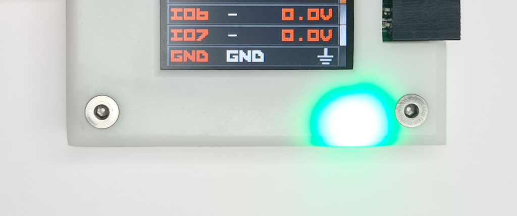

LED-()> [0x00ff00.24 RESET TX: 0x00FF00.24 LED-()>
Green is controlled by the second eight bits of data.
- Type
[0x00ff00.24followed byenterto light the green die.

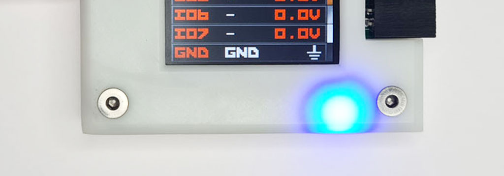

LED-()> [0x0000ff.24 RESET TX: 0x0000FF.24 LED-()>
Blue is controlled by the last eight bits of data.
- Type
[0x0000ff.24followed byenterto light the blue die.

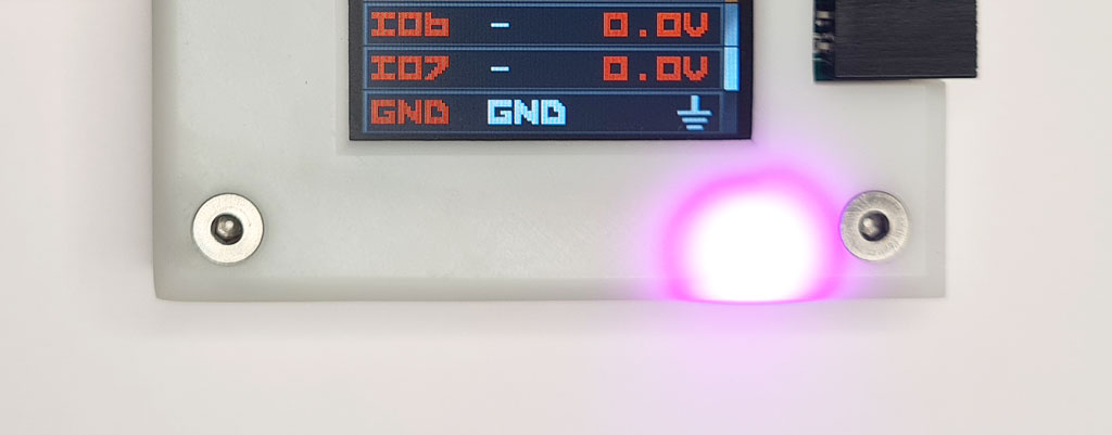

Purple
LED-()> [0xff00ff.24 RESET TX: 0xFF00FF.24 LED-()>
At this point you may wonder if you can mix colors. Why, yes, you can! Let’s try red plus blue.
- Type
[0xff00ff.24followed byenter. - The red and blue die light to full brightness.
- The color changes to purple.

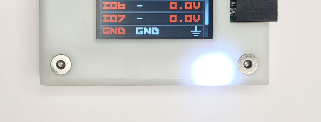

LED-()> [0xffffff.24 RESET TX: 0xFFFFFF.24 LED-()>
Through the magic of additive color we can make a whole rainbow of tones and shades. We can also make something approximating white light using all three dies.
- Type
[0xffffff.24followed byenter. - All three LED dies light to full brightness.
- The color is a sort of white at the cool (blue) end of the spectrum.

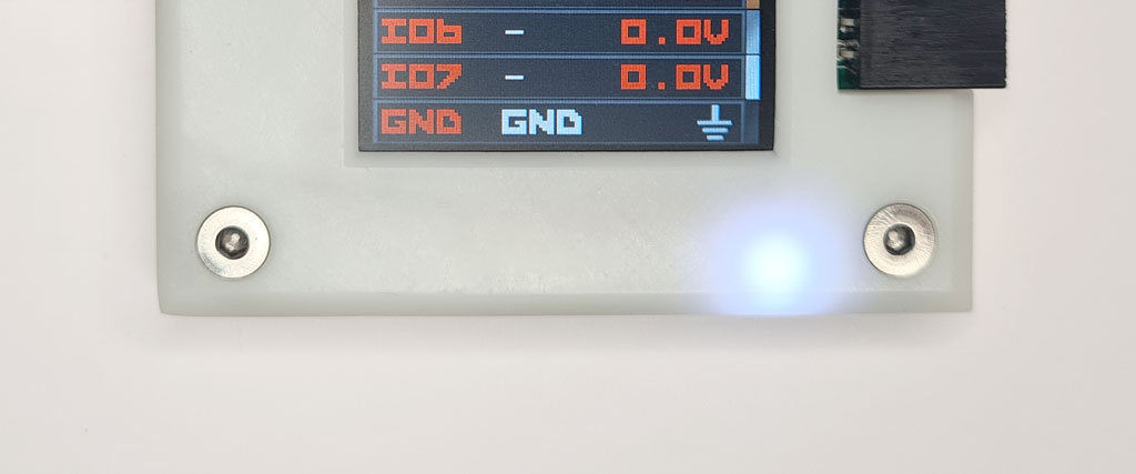

LED-()> [0x808080.24 RESET TX: 0x808080.24 LED-()>
Finally, send a command to set all three dies at half power.
- Type
[0x808080.24followed byenter. - All three LED dies are lit at half power and the brightness is reduced.
- The SK6812 controller chip in the LED uses pulse-width modulation to blink the dies on 50% of the time and off 50% of the time.
Even though the LED dies are only lit 50% of the time it doesn’t appear half as bright. This is because human perception of brightness is non-liner. To make it really dim try sending a smaller value like 0x10: 0x101010.24 followed by enter.
