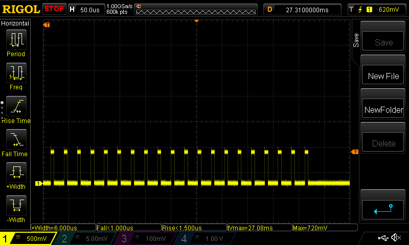

The current through the LEDs is equal to the current through the selected resistor (R6, R11, R13). Using Ohm’s law we should be able verify the transmit current by measuring at the high side of the resistors (red arrow).

Base voltage
First, let’s check the voltage at the base of the transistor (Q3 pin 1). Two diodes (D9, D10) offset the base voltage by 1.2-1.4 volts. 1.33 volts, so far so good.
100mA transmit current
Now, with the jumper in the 100mA position, we measure the voltage at the high side of R13 (6.8 Ohms). 0.65 volts/6.8 Ohms = 0.0955A = 95.5mA. This is close enough to the 100mA target. A safe level to run these LEDs continuously.
100mA is the maximum continuous current for these LEDs. Higher currents are possible, but must be a pulse modulated signal (PWM) with less than 50% duty cycle or the LEDs may be damaged.
200mA transmit current
With the jumper in the 200mA position, the voltage at the 3 Ohm resistor measures 0.62volts. 0.62 volts/ 3 Ohms = 0.206A = 206mA. This is close enough to the 200mA target.
Only use the 200mA setting at 50% duty cycle or less. Continuous operation at 200mA will damage the LEDs.
300mA transmit current
Finally, with the jumper in the 300mA position, the voltage at the 1.2 Ohm resistor measures 0.47 volts. 0.47 volts/ 1.2 Ohms = 0.391A = 391mA. This is a bit high, but the idea is to get as close to maximum as possible.
Only use the 300mA setting at 50% duty cycle or less and short bursts of less than 100uS. Continuous operation at 300mA will damage the LEDs.
