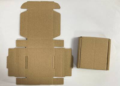

Cardboard Boxes
| Product | T Box |
| Bus Pirate 5 (PCB & enclosure, PCB only) | 9x9x2cm (7.5x8.5x1.5cm inner) |
| Probe/Auxiliary Cables | 7x7x2cm (5.5x6.5x1.5cm inner) |
At sizes this small, the T box type has a lot more strength than a small box but doesn’t have as much interior space.
