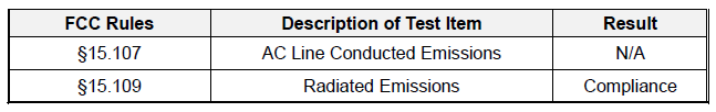

FCC/CE compliance testing
In the final days of July we passed FCC and CE testing on both boards and geared up production. By a minor miracle hardware shipped days after the RP2350 launch.
