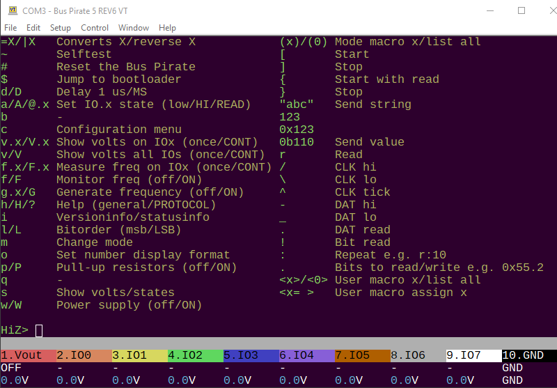

Commands are entered into a serial terminal. A new VT100 mode supports color text and a status toolbar that displays the function and voltage of each pin.

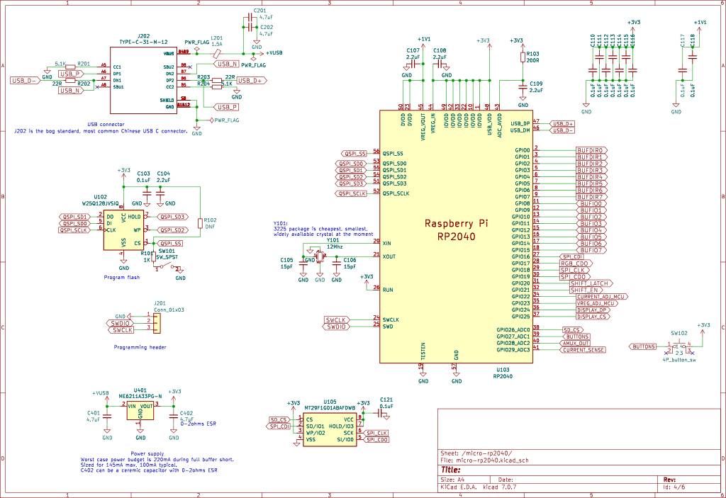

RP2040
It’s like the RP2040 was designed for a Bus Pirate. Two ARM cores, cheap external flash storage - and the 8 PIO state machines are a true hardware interface to just about any esoteric protocol. No more bit-banged software libraries!
The RP2040 (U103) has a built-in bootloader that appears as a USB disk drive - just drag a firmware file into the drive to update the Bus Pirate. The bootloader is locked in ROM, there’s no chance of accidentally erasing or corrupting it. What a happy little chip!
We paired the RP2040 with a 128Mbit flash chip (U102), the maximum supported. There should be plenty of room to add features for years to come. All that space has already paid off with features like multi-language support in a single firmware release and integrated device demos.

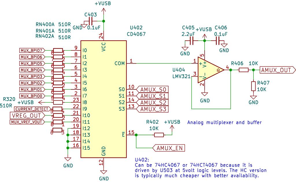

Live voltage measurement on every pin was an absolute feature requirement for Bus Pirate 5. We want to to see whats happening at a glance, not perform bizarre and uncomfortable acrobatics with multimeter probes.
The RP2040 only has 4 analog to digital converter inputs, so we added a 16 channel CD4067 analog mux (U402). The mux connects the IO pins, the programmable power supply and various test points to a single RP2040 ADC pin.All those 510R series input resistors are intended to limit back powering to tolerable levels (10mA).
An op-amp (U404) buffers the mux output and feeds a divide by two 10K resistor (R406/R407) pair. This allows the 3.3volt ADC to measure signals up to 6.6volts, however in practice the maximum voltage can not exceed the USB power supply (~5volts) without damaging other components.
A user reported a periodic glitch on the REV8 preview board IO pins. It is especially noticeable on open collector bus types with pull-up resistors when the adjacent pin is grounded. The analog mux has some capacitance that causes the pin voltage to sag after switching channels. REV10 adds quad op-amps (U504, U505) as a buffer between the IO pins and mux, which solves the glitch issue.
Op-amps are pretty delicate, and tend to die if a voltage is connected while they’re not powered. Fortunately, most op-amp inputs are rated for +/-0.3volts-0.5volts from the power supply rails. We take advantage of this to limit the maximum powered-down voltage using a Schottky diode (D500, D501, D502, D503, D504) with a very low forward voltage (0.2volts @ 0.05mA) and a high value (100K) current limiting resistor (RN317, RN318). Care must be taken to choose a Shottky with low reverse current, many cheap diodes are leakier than you expect and will cause a voltage offset on floating pins.

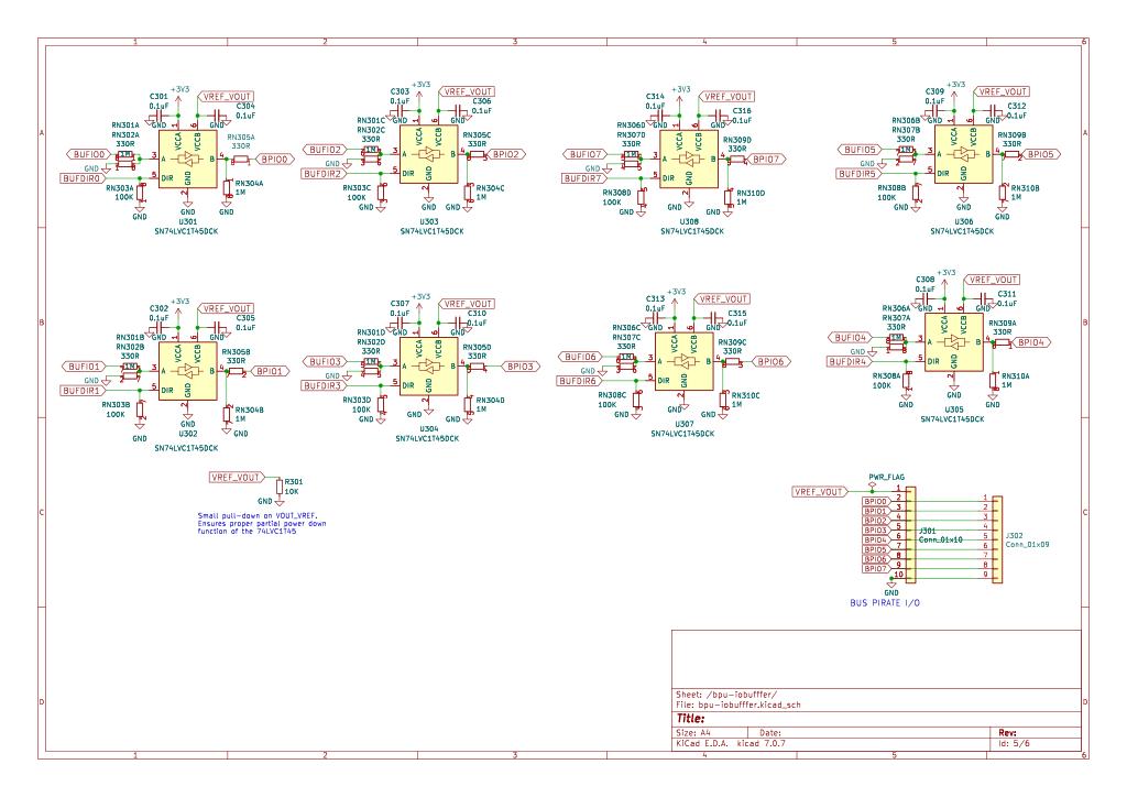

8 IO Units
1.2-5volt Buffers

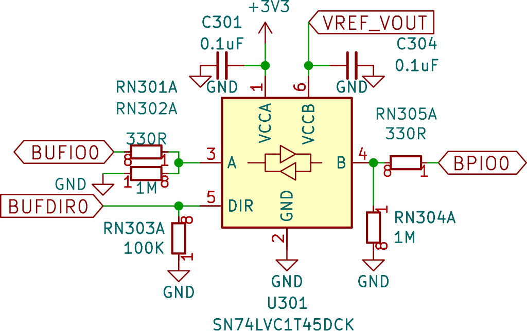

IO pins are fitted with 74LVC1T45 bidirectional buffers, we call this chip ’the bulldozer’. Half of the buffer is powered at 3.3volts to interface the RP2040. The other half is powered from the VREF/VOUT pin at 1.2-5volts to interface with the outside world. 74LVC1T45 has great specs for hacking, like 5.5volt tolerant pins and a feature that disables everything when either half of the buffer is unpowered.
Two RP2040 pins control each buffer: one sets the direction (input/output), and one does the actual IO (high/low/read). In the past this setup forced us towards a CPLD or FPGA to deal with bidirectional protocols like I2C, but the RP2040 PIO peripheral does a great job of managing the buffer.
Care must be taken so the buffer and RP2040 don’t draw excessive current from each other. This happens when both pins are set to output at the same time, one high and one low. To prevent damage we limit the maximum current draw with 330R series resistors on each 74LVC1T45 IO pin.

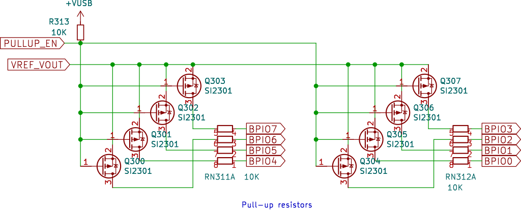

Toggleable Pull-up Resistors
Each IO pin has a toggleable 10K pull-up resistor. Onboard pull-ups are controlled by eight SI2301 PFETs with a very low (<1volt) gate threshold voltage. Pull-ups are powered through the VOUT/VREF pin.
Eight SI2301 PFETs replace two 74HC4066 chips for pull-up control. This change lowers cost, simplifies the circuit and saves board space. They operate identically over the 74LVC1T45 operating range (1.2-5volts). However, there is a point at which each PFET will not fully turn on when VOUT/VREF is lower than the maximum gate threshold voltage (<1volt).

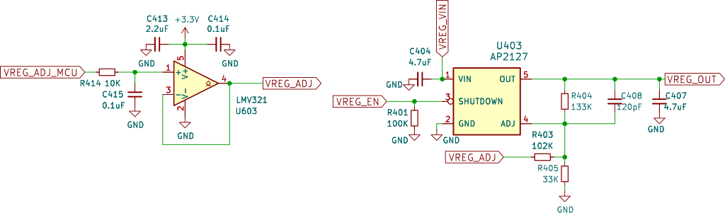

The heart of the programmable power supply is a 0.8 to 5volt adjustable output voltage regulator (U403). Normally fixed resistor values set the output voltage of an adjustable regulator, but we’ve given it programmable output by margining the feedback pin with an RP2040 pulse width modulator. The PWM output of the RP2040 is filtered through a 10K resistor (R414) and 100nF capacitor (C415), then buffered with an op-amp (U603).
Older adjustable voltage regulators typically have a range from 1.25 to 5volts or more. A newer class of regulators go a bit lower - down to 0.8volts.
We worked with two regulators during development: MCP1824 from Microchip, and AP2127 from Diodes INC. They have the same pinout and similar specs, but the MCP1824 has a 0.41volt reference while the AP2127 has a 0.8volt reference. We prefer the MCP1824 because the reference value makes it easier to select common resistors for the margining circuit, but it has become expensive and at times hard to find.
0.8-5volts is the voltage regulator range, but the PFET used in the backflow prevention circuit may not turn on when the output is less than the gate threshold voltage (1volt max). The average gate threshold for the SI2301 in REV10 is <0.4volts, but that is not guaranteed, the Vgth will vary. For this reason, the Bus Pirate power supply is specified for 1-5volts output, but you might just get lucky!
300mA is the rated maximum of the voltage regulator, but we added some headroom in the current limit circuit to account for current spikes.
| Part | Ideal Value | Closest Value | ||||
| R403 | R404 | R405 | R403 | R404 | R405 | |
| MCP1824 | 77.96K | 99.22K | 10K | 78K | 100K | 10K |
| AP2127 | 103.13K | 131.25K | 33K | 102K | 133K | 33K |
MCP1824 and AP2127 are similar, but each has a different reference voltage. R403/R404/R405 need to match the regulator as shown in the table.
A common 1.25V-5V adjustable regulator can be used with the correct resistor values (see calculations spreadsheet). The Bus Pirate will lose features though. The output range will be limited to 1.25volts to 5volts, instead of ~1volts to 5volts.

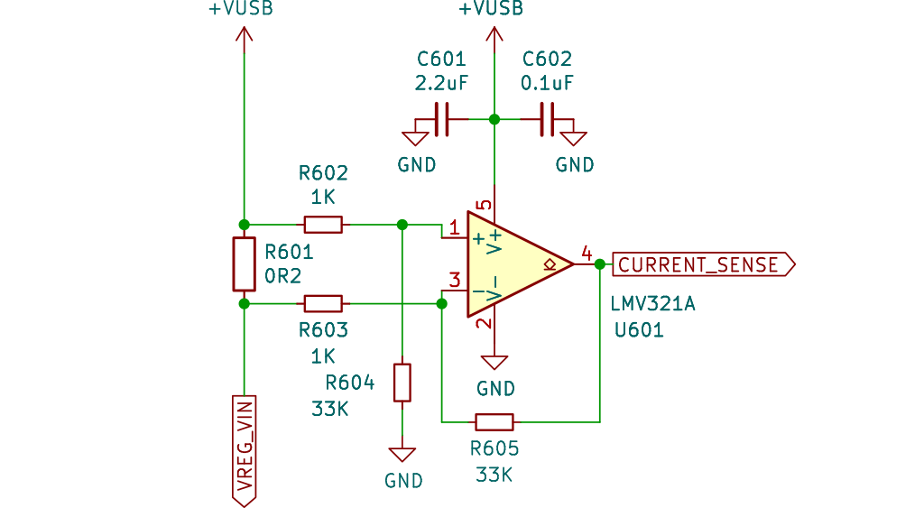

Current Sense
Current consumption can be used as a proxy to debug a circuit. Is there a short? Is this chip even running? This is certainly evident in the Shenzhen mobile phone repair markets where current meters taped into cardboard boxes are the go-to tool for diagnosing iPhone motherboard failures.
A 200m resistor (R601) causes a slight voltage drop in proportion to the current passing through it. An op-amp (U601) amplifies the difference approximately 32 times, scaling 0–500mA current use to a 0–3.3V output that we can measure with the RP2040 ADC.
Current sense is measured with a dedicated RP2040 ADC instead of passing through the analog multiplexer. This is because the mux is followed by a voltage divider that would cut the measurement resolution in half. That wouldn’t be fair to our hard working little op-amp!
Beginning with REV10 we use an ‘A’ graded op-amp with lower maximum input offset (0.1mV typical, 0.4mV max @25C -vs- 0.4mV typical, 3.5mV max @25C) for improved current measurement accuracy.

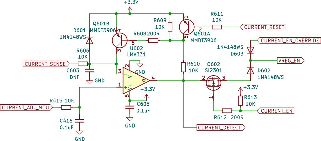

Programmable 0-500mA Current Limit
Since we’ve already got current consumption scaled to a 0-3.3volt output signal, wouldn’t it be cheeky to pop a comparator behind it to make a programmable fuse?
The scaled current sense output hits the comparator (U602) on the - pin. The limit is set with another filtered (R415/C416) pulse width modulator output to the comparator + pin. When the current sense voltage on the - pin exceeds the limit set by the PWM on the + pin, the output (VREG_EN) inverts which disables the voltage regulator.
This doesn’t quite get us there. When the voltage regulator disables current use drops, causing the comparator to flip back on. This creates a loop where the VREG oscillates on and off. That’s definitely not what we want.
A PNP transistor pair (Q601A/B) and a few passive parts capture the inversion and hold the comparator in the off state. The PNP pair sustains a current path through the two transistors until it is forcibly changed by an outside voltage (CURRENT_RESET).
A PFET (Q602) connected to a 74HC595 pin (CURRENT_EN) enables/disables comparator control of the voltage regulator. Two diodes (D602/D603) create a logical OR with another 74HC595 pin (CURRENT_EN_OVERRIDE) so the current limit can be overridden completely.
There you have it, a programmable fuse with just a couple extra parts.

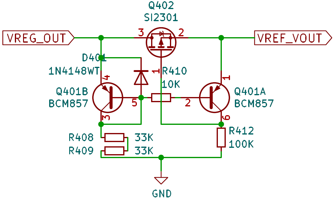

Backflow Prevention
A backflow prevention switch helps protect all the little analog bits when an external voltage is applied to the VOUT/VREF pin. A closely matched PNP pair (Q401A/B) creates a current mirror that controls a P-channel MOSFET (Q402) high-side switch. When the voltage on VREF/VOUT is greater than the voltage in the PPSU, the PFET turns off.
The Bus Pirate monitors the voltage on both sides of the PFET, and displays a warning when VREF_VOUT is greater than VREG_OUT.
| Symbol | Parameter | Conditions | Min | Typ | Max | Unit |
| hFE1/hFE2 | hFE matching | VCE=-5V; IC=-2mA | 0.9 | 1 | - | - |
| VBE1-VBE2 | VBE matching | VCE=-5V; IC=-2mA | - | - | 2 | mV |
Q401 requires a closely matched PNP transistor pair. The hFE of the transistor pair should differ by no more than 10%, and the VBE should differ no more than 2mV.
While the adjustable voltage regulator is capable of 0.8 to 5.0volt output, the gate threshold of the PFET determines the minimum output. Common inexpensive PFETs generally have a maximum gate threshold of -1volt or more, and therefore may not fully turn on in the 0.8-1volt range.
R408/R409 are two 33K resistors instead of a single resistor. This was done to reduce the number of parts in the BOM and save a pick and place feeder during development.

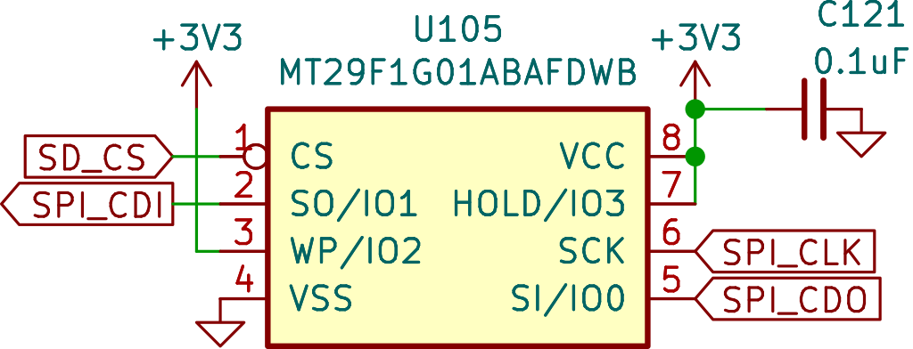

1Gbit NAND Flash
A 1 Gbit NAND flash chip is connected to the RP2040 via an SPI bus shared with the LCD and 74HC595 IO expanders. NAND flash is cheap and commonly used in removable storage, but it’s also messy and prone to error. Bad block detection/marking and wear leveling all need to be managed in the RP2040 or the chip will die an untimely death.
NAND flash is used to save global and mode configuration in simple JSON files. It can also be used for all kinds of interesting things, like firmware storage for production programming, saving dumps from flash chips and EEPROMs or logging bus communications.
NAND flash appears as a readable and writable USB disk drive, however the speed is quite low because there are only enough RP2040 pins to implement a one bit SPI interface.

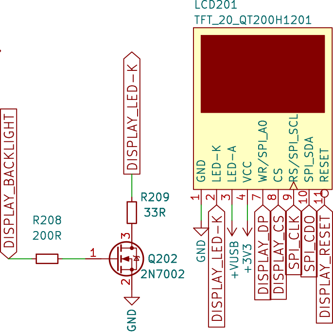

LCD
A beautiful 240x320 pixel color IPS (all angle viewing) LCD acts as a pin label, displays the voltage on each pin and shows the current consumption of the programmable power supply unit. The LCD shares an SPI bus with the NAND flash and 74HC595 IO expanders. The display is already FCC certified, which doesn’t exempt us from certification, but a bad LCD can spray radiation all over the spectrum causing us to fail.
The LCD background image is a bitmap converted to a C byte array and included in the firmware. Several open source font sets were converted to bitmaps for the display.
