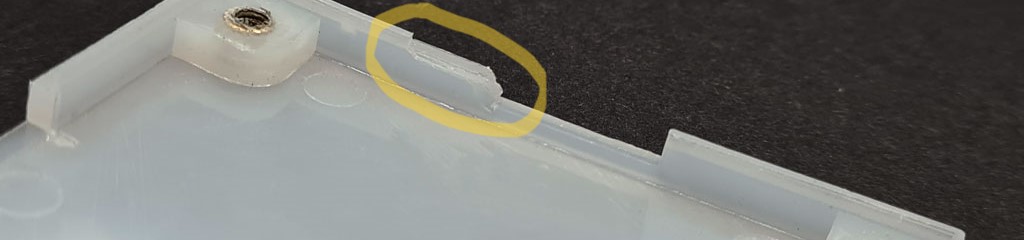

Thousands of bits of plastic descend on our office. The color is right and the outside is pretty nice, but 100% have reject worthy defects.
- Part of the wall is missing on every case
- Positioning pegs for the 9P auxillary connector are missing/deformed on every case
- Insert nuts are in the wrong place or buried
- Enough plastic leaked into the base of the insert nut that 8mm bolts no longer sit flush against the front of the case
