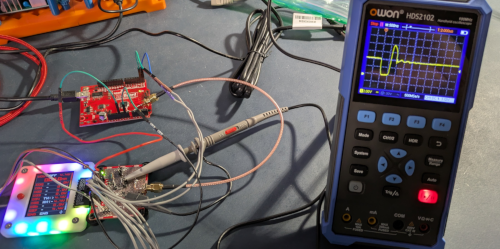

To try to bypass or glitch the password authentication routine, the power glitching attack will “short” the voltage to the Arduino’s microcontroller for a very short period. The duration and timing of this attack is crucial to success.

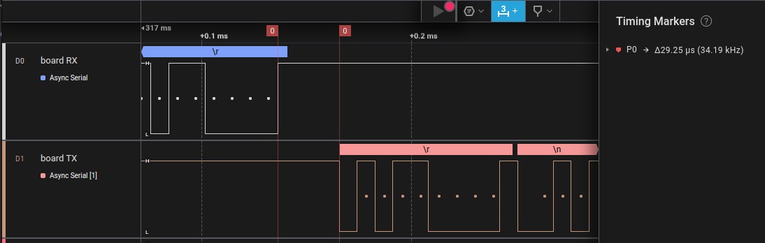

The first step would be to use a logic analyzer to determine if the timing between the user sending a return on a bad password attempt and the target sending the next prompt is constant (or at least has little variation). The easiest way to do this is to use a logic analyzer on the TX and RX lines and measuring the time:
The Bus Pirate has a follow along logic analyzer built in that can be used for this.
In the above trace, the timing between the end of the user’s input (top trace), and the target sending the prompt to try again is 29.25 microseconds. Doing this test many times showed that this timing was pretty constant.
Knowing this, it is reasonable to guess that the password validation routine is happening some time between 10 and 20 microseconds after the user’s attempt is received by the target.
The only way to know for sure is through experimentation, but the logic analyzer has narrowed the timing down.

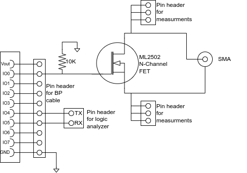

The Glitch command will activate Bus Pirate IO0 during the attack; that output will turn on for a very short time when triggered. It is implementation dependent to make use of this.

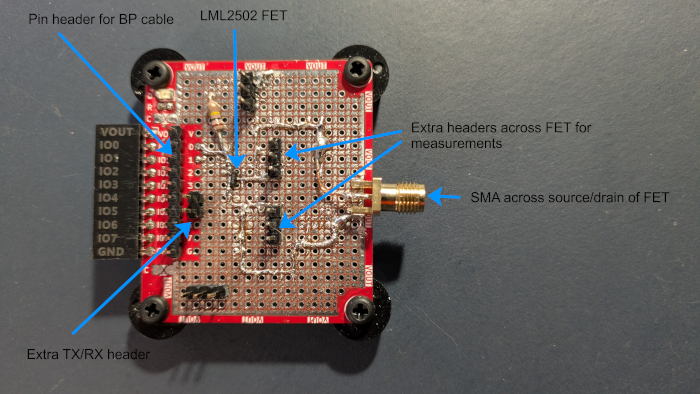

In this case, a custom Blank Plank is used to do the power glitching. Here is the schematic:
The actual plank:

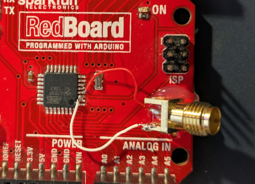

The way it works is that the FET will fire when the Bus Pirate triggers the glitch. The Target (Arduino, in this case) is connected across the FET via the SMA connector. At the Arduino side, the connection is directly across the VCC and GND pins of the AVR microcontroller.
It is essential that the connection is as close to the microcontroller pins as possible. For the demo, the connection was made directly to the MCU pins:
