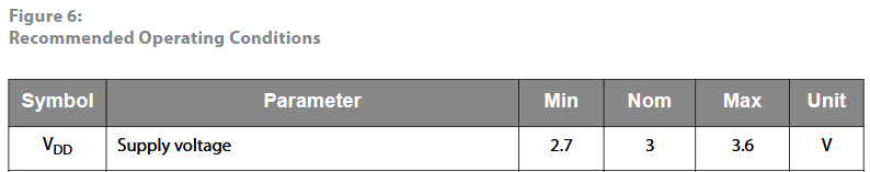

Power supply
According to the datasheet, the TSL2561 requires a 2.7-3.6 volt power supply.
Image source: datasheet.
I2C> W 3.3 3.30V requested, closest value: 3.30V 300.0mA requested, closest value: 300.0mA Power supply:Enabled Vreg output: 3.3V, Vref/Vout pin: 3.3V, Current: 2.8mA I2C>
Let’s set the Bus Pirate to power the chip at 3.3volts, a very common voltage for modern I2C devices.
