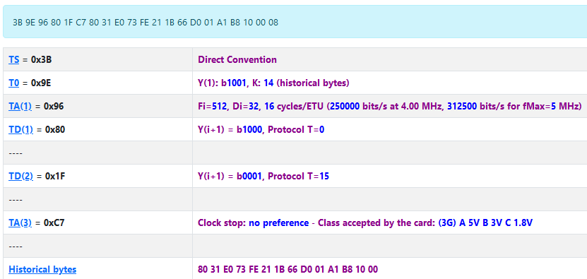

Decoding the ATR gives us several interesting pieces of info about this SIM:
- TS=0x3B - Direct Convention, normal SIM ATR response
- fMax=5MHz - maximum clock frequency is 5MHz
- Class=A 5V B 3V C 1.8V - the card can operate at 5 volts, 3 volts, or 1.8 volts
Based on a database of ATR responses, the website suggests this is a Lyca Mobile SIM from Austria. That’s close enough, it’s a free Dutch Lyca Mobile SIM from Amsterdam China Town.

HDPLXUART> a 2; @ 2 IO2 set to OUTPUT: 0 IO2 set to INPUT: 1 HDPLXUART>0x3b 0x9e 0x96 0x80 0x1f 0xc7 0x80 0x31 0xe0 0x73 0xfe 0x21 0x1b 0x66 0xd0 0x01 0xa1 0xb8 0x10 0x00 0x08
A cheap 4G travel SIM from IMG in Hong Kong.

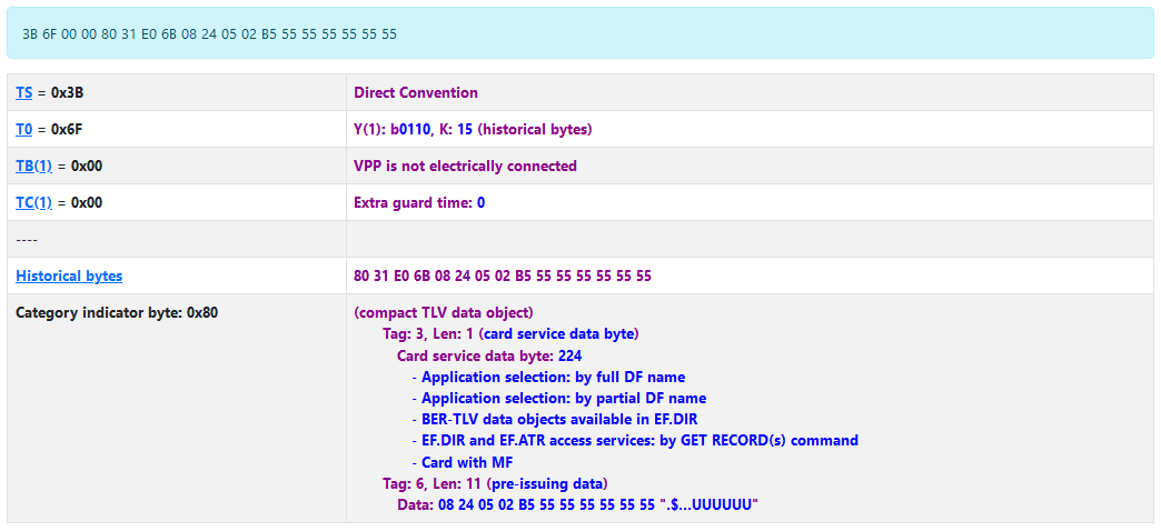

HDPLXUART> a 2; @ 2 IO2 set to OUTPUT: 0 IO2 set to INPUT: 1 HDPLXUART> 0x3b 0x6f 0x00 0x00 0x80 0x31 0xe0 0x6b 0x08 0x24 0x05 0x02 0xb5 0x55 0x55 0x55 0x55 0x55 0x55
A Visa debit card from a US transit system.
