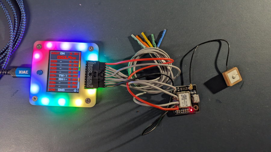

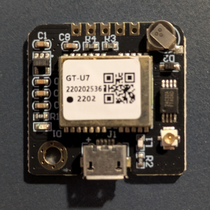

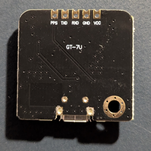

GPS modules usually have at least 4 connections: VCC, GND, TX, and RX. The actual location and order of these connections can vary from module to module and should be verified by the datasheet or silkscreen labels on the board. The GPS module may have additional signals, but only the 4 listed above are needed.
Bus PirateGPS ModuleDescription
VoutVCC3.3 volt power supply
IO4/TXRXTransmit from Bus Pirate to GPS receive
IO5/RXTXTransmit from GPS to Bus Pirate receive
GNDGNDGround
The connections can be made with the Bus Pirate cable, clips, or “dupont” style jumpers.

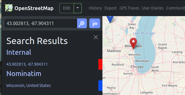

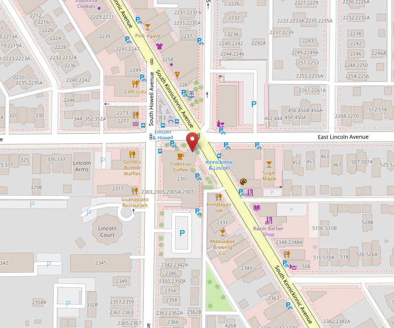

$GPRMC,141458.00,A,4300.16985,N,08754.25421,W,1.481,,151025,,,A*6B
$xxRMC: raw coordinates and speed: (430016985/100000,-875425421/100000) 1481/1000
$xxRMC fixed-point coordinates and speed scaled to three decimal places: (4300170,-8754254) 1481
$xxRMC floating point degree coordinates and speed: (43.002831,-87.904236) 1.481000
