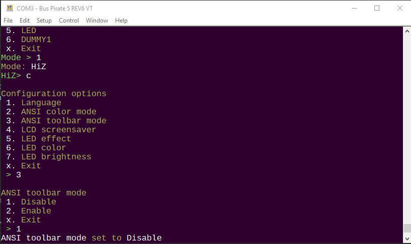

Disable the Bus Pirate toolbar
The screen redraw activity form the Bus Pirate toolbar will make a mess in the output. Open Tera Term and disable the toolbar before logging.
  • From the Bus Pirate command prompt choose c for the configuration menu.
  • Choose ANSI toolbar mode and Disable.
Remember to close your terminal before running the script.
