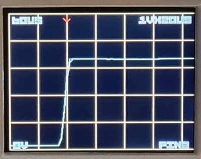

Display overview
The display is small, to make the scope more useful we have a much larger capture buffer than the actual display and software scales the captured data to fit. The actual resolution is 0.5M samples per second. In the 100uS/div range that’s one sample per pixel, any faster (50uS/div and below and samples are interpolated on the screen). If possible we try and capture up to 10 samples per pixel at whatever the current resolution is so that you can zoom into captured data at least 10 times (3 steps) before we start interpolating.
  • The text ‘1V x 100uS’ in the top right is the scale (voltage X time), the size of 1 yellow square on the screen. The default scale is “1V x 100uS” - 1 volt by 100 microseconds
  • The text ‘0mS’ in the top left is the offset (in time) of the left hand vertical yellow line
  • The text ‘0V’ in the bottom left is the offset (in volts) of the bottom yellow line
  • The text ‘PIN0’ in the bottom right tells you which input pin is being sampled
  • If the trigger point for the current trace is visible on the display then a small red arrow will appear at the trigger point at the top of the display
By default the screen displays 0V-5V in the vertical direction and 0uS to 640uS horizontally. The data on the screen is a window into a larger display buffer. After taking a trace you can move around inside the buffer to explore different sections of the data.

Now we’ll use the pull-up resistors to trigger the scope:
  • P and enter to turn on the pull-up resistors. You should see a trace with a rising edge
  • p and enter to turn off the pull-up resistors. You should see a nice exponential decay curve on the scope as pin 2’s capacitance discharges
